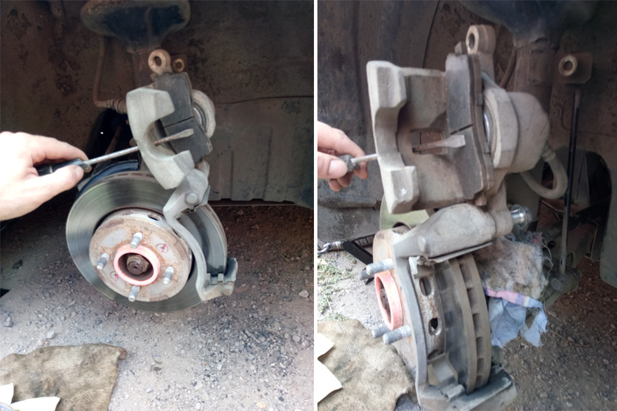

ymqvxYIKqS4.jpg?size=604x300&quality=96&
